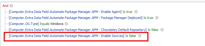

The first part, should not happen unless something changes in the EDFs to cause the Enable Source box to be empty or (False).
Screenshot 2024-08-29 095322.png (13.41 KiB) Viewed 14948 times
I am not sure why that would disapear, I do not have anything in place that I am aware of that clears these fields. Let me go have a look at the full path a sourced agent traverses to see what might trigger such an event.
