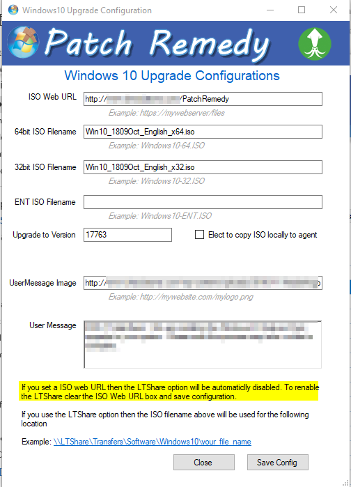

Hello - We need to be able deploy Win10 Upgrades through patch remedy on machines that either can't reach the Drive variable location, or the location doesn't have a Drive variable set.
We have the ISO hosted in our webspace and the configuration for PR set to pull the ISO from there.
When I tried to have it run on my machine (which is outside of our network, but in the "Main" location so there is a Drive variable set) it came back with the error that it could not reach the network share to download the ISO.
I then moved my computer into a location with no Drive variable. Did the update config, verified in the Effective policy that nothing was set for the network share. I triggered the update again and this time it gave me an error I believe saying the location didn't have a LTShare set, but I am trying to recreate to verify.
To actually get it to install, I had to set the Drive variable to \\127.0.0.1\LTShare, create that folder on my desktop, share and share it. Then it finally let me do the upgrade.
Based on the documentation I have read, the webspace option disabled teh LTCache option and is supposed to be for if machines are unable to reach the ltcache, so I am a little perplexed if why it is needing an LT cache to download and install from the webspace..

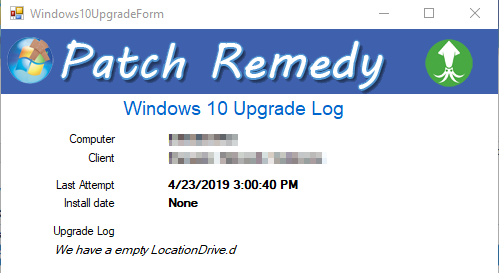

Any help on this?
I had someone review the script code and even it looks to be requiring a drivelocation no matter what even though that is not what the setting page nor the documentation say when using the web URL
Even with this set like this, I get this error when trying to update a machine in a location with no drivelocation set.
Would really like some input on this as this was one of the big things we wanted to utilize PatchRemedy for and not being able to to this is a major setback.
