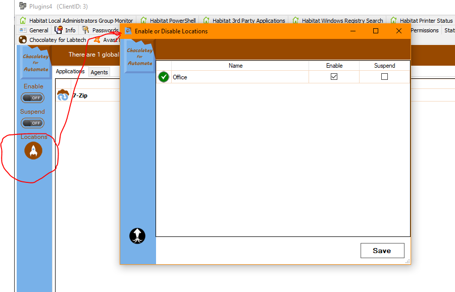

We released 3.0.0.38 today
https://delivery.shopifyapps.com/-/0b0c ... a70b31d347
Now supports enabling by location.
New Locations Button will launch locations enabler.
To use select to enable or not any location. The Suspend feature is not yet implemented so enable or disable the location will prevent installs for agents at that location. These events will be logged in the plugin log.
