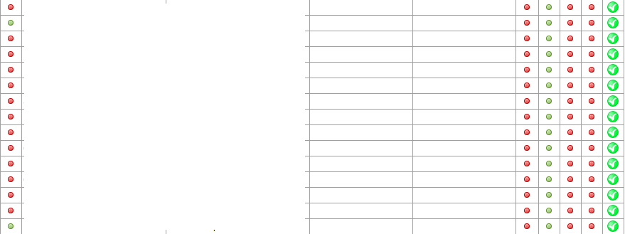

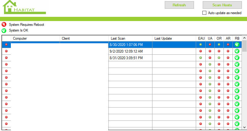

I am really enjoying learning about this tool and love the extra features, but the main reason I got it was for the MacOS update tool. Currently right now I am having an issue that a lot of the commands from the UI are not running (or not seeing any visible changes). I try to adjust the settings for the mac to allow Auto Update and Only Recommended ones, but the red dots do not change from Red to Green, I have exactly two Mac's that I am able to adjust but I have a long list of others that are not responding. I can however connect to them through the agent and I know they are online.

Ok, are you seeing the scripts being scheduled on your Mac Agents? Can you post some screen shots and script logs that reference the Habitat Mac scripting?
Also as 1.0.0.51 we have an automated service manager. Can you post a screen shot of the Mac Updater setting in that control?

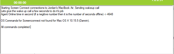

When I try to run the screenconnect command under the stalled agent section to get them to respond I get this error
