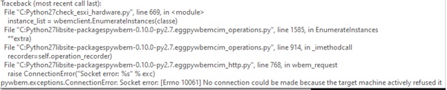

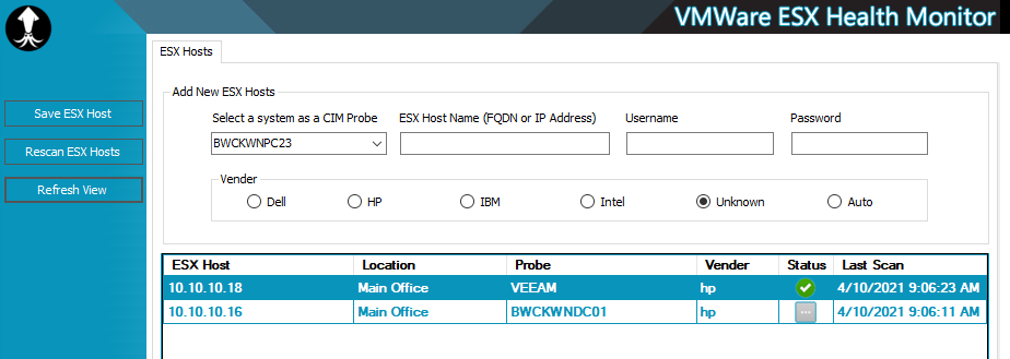

We are adding a server as a esx host within automate and receive an error 'no connection could be made because the target machine actively refused it. I've attached screenshots of the error as well? Looks like python can't check the request.
Unable to probe ESX host
- VMware health monitor.jpg (36.5 KiB) Viewed 16981 times
- VMware monitor.PNG (31.97 KiB) Viewed 16981 times

Next the error for Actively refused connection is that CIM services are not running on the port being queried so the port on the ESX host is "actively refusing" connections on that port. This means CIM service has died (see this alot) try rebooting ESX host or CIM is disabled in which the above post should help you get it enabled and functional for querying.
So try those 2 pills first and see if either lead to a resolution.
If it was a password or some error parsing the CIM DATA you would not get this refused error. This only comes from port denial. So could be a firewall on ESX host aswell, again the above post should help get you sorted.
viewtopic.php?f=31&t=5228&sid=389ab88e6 ... 003a6050a2

We are having the same issue with 7.0 Update 3. I followed your instructions and verified all services are running, but getting the Python errors mentioned above. Any further ideas to try?epicit wrote: Mon Oct 04, 2021 2:10 am Hi guys,
