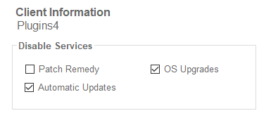

If you go to each client and check all boxes then nothing will run on that client at all. I would check everything but the "Patch Remedy". This will allow the passive scans to collect agent data but will preform not tasks against the agents. This will get the plugin data populating so you can get patch counts and percentages forming.
Like so:
This setting will allow the scans across client but all agents will be (are) set to no PR patching or OS upgrades.
