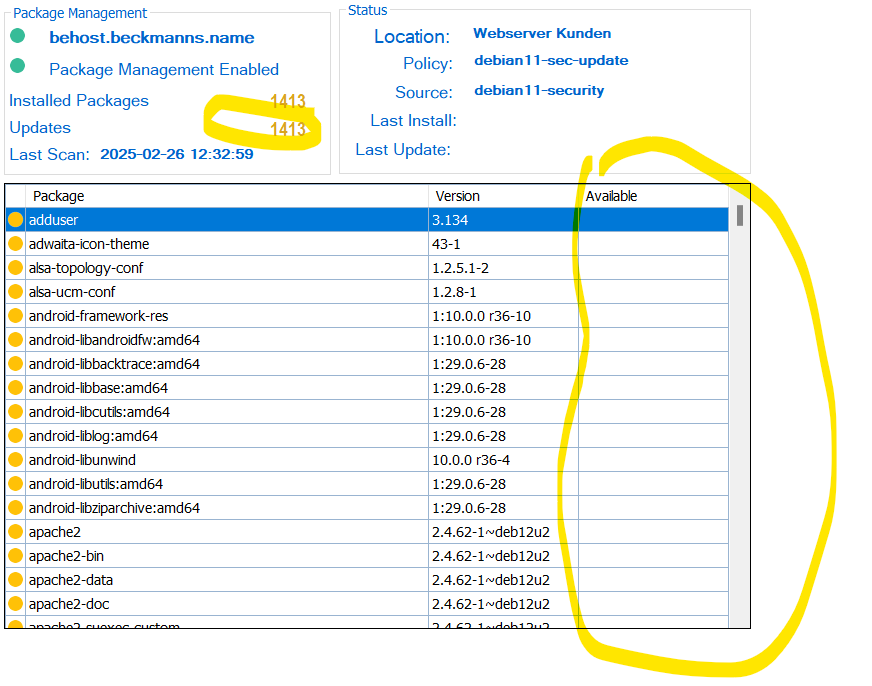

i run the scanner script - should there be the version number in the column available ?

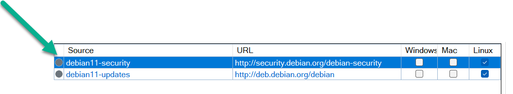

and in the list of sources, should the button be green ?
Re: Sources
Posted: Thu Feb 27, 2025 5:55 pm
By default you do not need to apply a source to your Linux distros unless you want to add a 3rd party repo to capture a LOB application or such. But yes, grey is the color of icon.

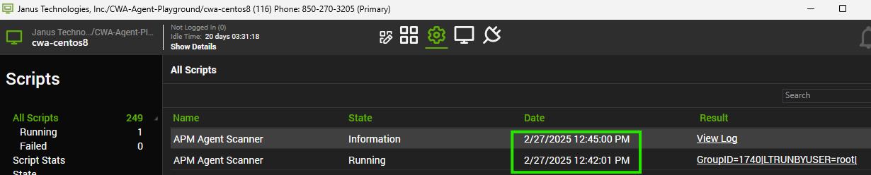

Scripts Log:
Screenshot 2025-02-27 125356.png (46.22 KiB) Viewed 11736 times

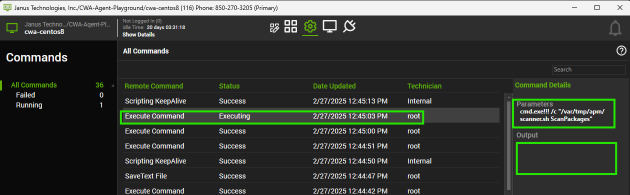

Commands Log
Screenshot 2025-02-27 125451.png (80.94 KiB) Viewed 11736 times

i think i found the problem:
Your script depends on english for the default system language
We have german System and so output for german is for example :
apt-cache policy bash
bash:
Installiert: 5.2.15-2+b2
Installationskandidat: 5.2.15-2+b7
Versionstabelle:
5.2.15-2+b7 500
500 http://ftp.de.debian.org/debian bookworm/main amd64 Packages
*** 5.2.15-2+b2 100
100 /var/lib/dpkg/status
and in english:
bash:
Installed: 5.2.15-2+b2
Candidate: 5.2.15-2+b7
Version table:
5.2.15-2+b7 500
*** 5.2.15-2+b2 100
You look for the string "candidate"
Can you check your sripts and change the language to english maybe with
LANG=en_US_8859_1
