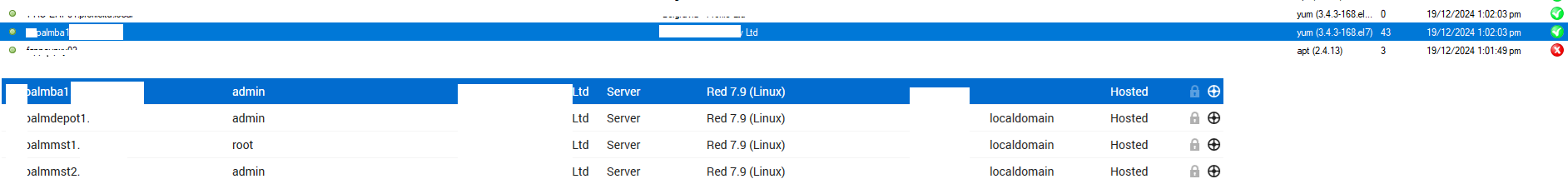

Top half of the screenshot is out of LUM
Second half out of Labtech
SQL query returns the machines OK
Screenshot 2024-12-19 143525.png (41.98 KiB) Viewed 3258 times
Re: Linux Patch Manager - not picking up all linux servers?
Ok that is interesting..
same query, 2 different responses..
Let me have a look at the code base so I can get a set of tests for you to execute. This should root out what maybe filtering the outputs.
