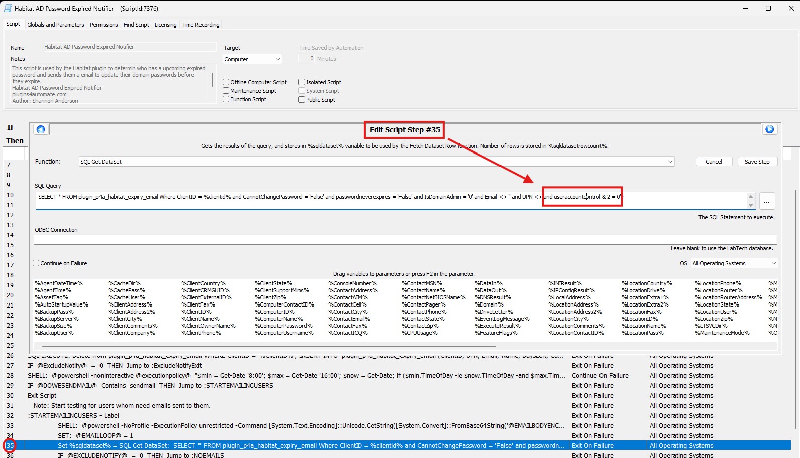

OK I have a fix in place for this which will be released in next build.
In the mean time the fix can be manually added to resolve your issue now.
Screenshot 2025-10-07 095434.jpg (368.52 KiB) Viewed 23022 times
Find the Automate Script (Habitat AD Password Expired Notifier) and edit line #35
In the SQL query section of script add the following to the end of SQL Query (AND userAccountControl & 2 = 0)
The entire SQL QUERY should look like
SELECT * FROM plugin_p4a_habitat_expiry_email Where ClientID = %clientid% and CannotChangePassword = 'False' and passwordneverexpires = 'False' and IsDomainAdmin = '0' and Email <> '' and UPN <> '' and useraccountcontrol & 2 = 0;
This will exclude disabled accounts.
