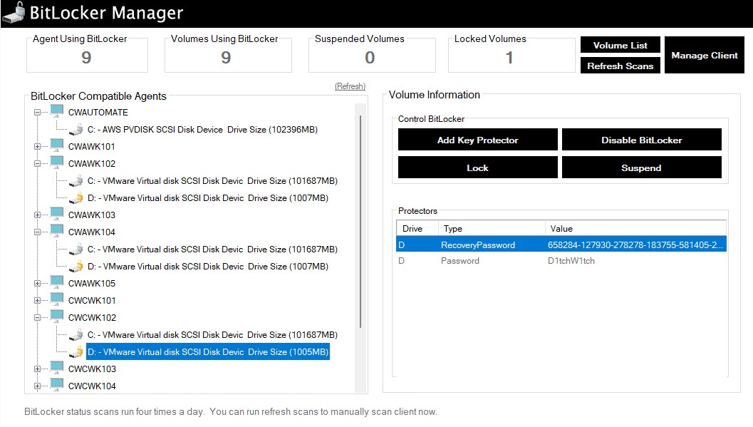

I have released build 1.0.0.23
Download Here
We have expanded the logic across all functions and improved response times. The Volume menu is now an active menu that changes as the state of the volume changes. I've added and removed controls based on drive volume state so that you can only manage functions that support the current state.
See our release notes at Here
I will rewrite the help documents as things have changed and simplified in the plugin.
