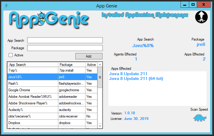

The App Genie Search manager allows you to modify how App Genie sees installed software associations. Lets talk about associations for a moment, App Genie uses Chocolatey NuGet (Chocolatey.org) as its application management engine. This framework uses powershell to manage the install , updates and removals of thousands of software titles. Kind of like a librarian of software install and updates. App Genie leverages this framework to match installed applications with available packages on the Chocolatey repositories. The MSP does not need the MSP version from Chocolatey. The plugin has all it needs to do the job fully.
App Genie uses search terms to define a software and to associate it with the correct Chocolatey repo package. Once it finds matches then App Genie gets to work making sure that the Chocolatey framework exists and is functional on the agent and that the applications found are updated. Then App Genie repeats this on a regular basis to keep all agents software up to date.
In the App Genie Search manager you can select a search and on the right side of the search you will see what applications will be effected inside your environment and how many possible agents may be effected during an upgrade. this helps you better define your searches to include or exclude software titles and improve the deployment of updates to the end agents.

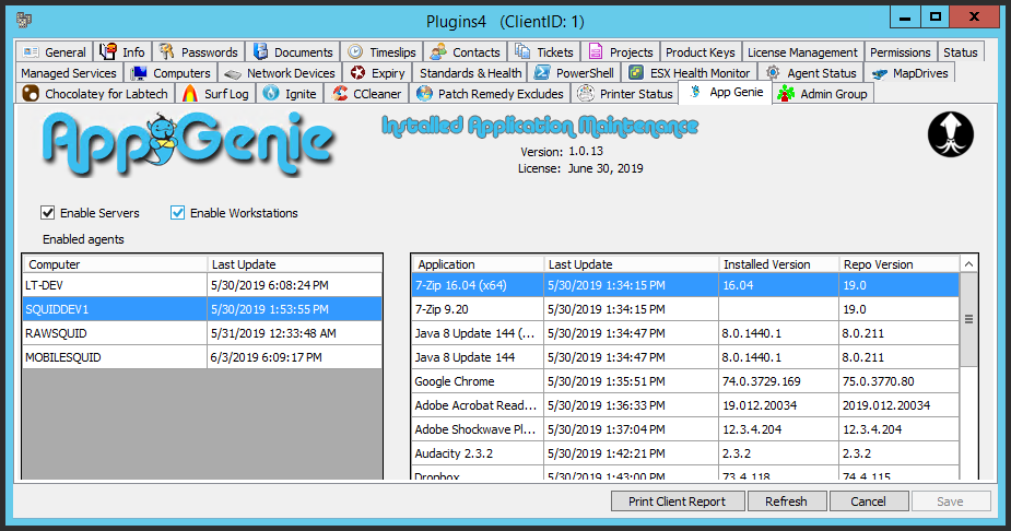

To have App Genie get started with a clients agents just open the client console and select from the check boxes which groups to start updating.
Allow App Genie a couple of days to get rolling with your updates. then forget about it! App Genie has your back.

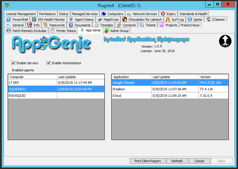

New in Build 1.0.9 is the Client view.
We added the successful application update listings to each selected agent. highlight the agent in the enabled agents list and see the applications App Genie has successfully updated.
