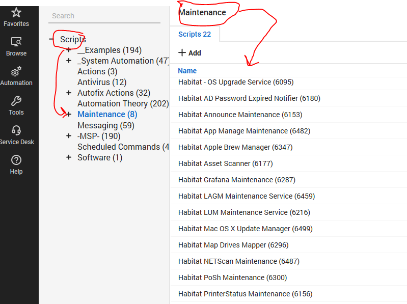

Can you confirm the following scripts are present?

Re: Windows Upgrade Assistant - Run Now and Schedule not working
Post by michaeldiaz »
Yes they are here:
