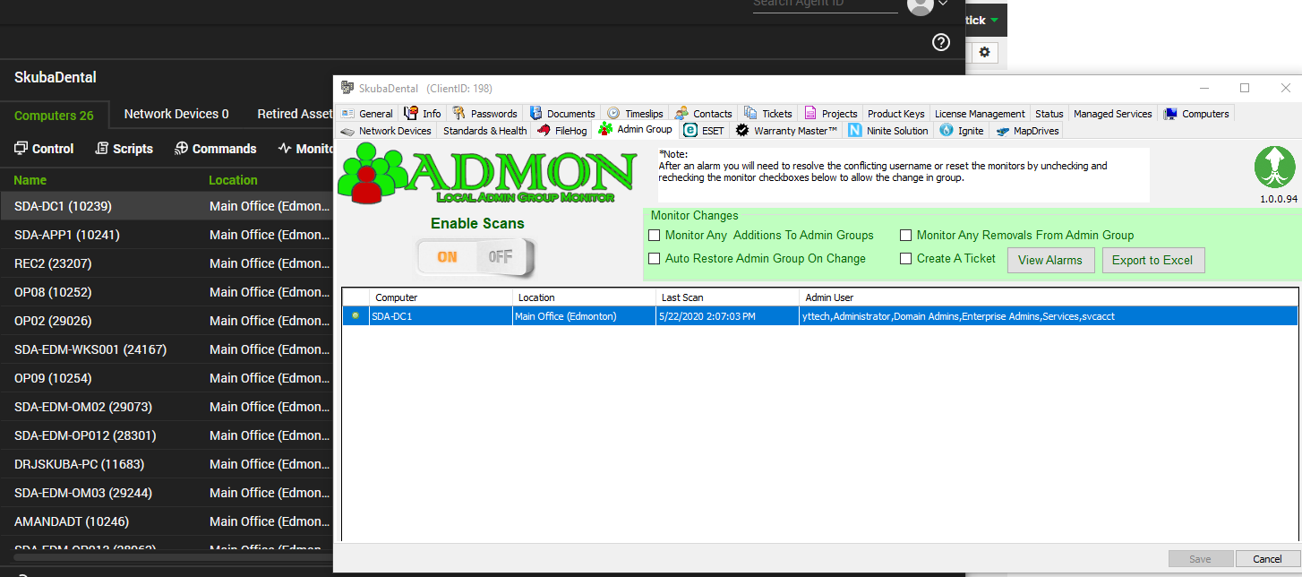

Hi There,
We have been using this plugin for a while now, but recently a site in LabTech only sees the DC, not any other PC at the site. Is there a way we can troubleshoot whats going on?
ADMon not detecting all machines at a site

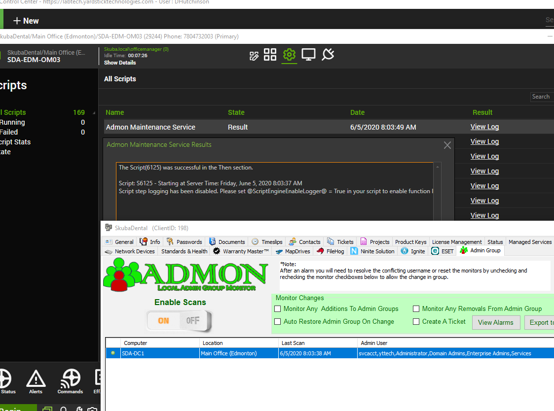

Hi Cubert,
The scrips seems to be running on the agent, and the script says it ran successfully.

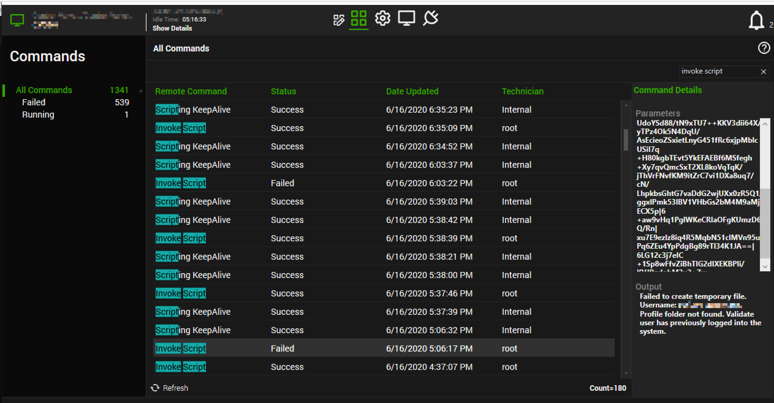

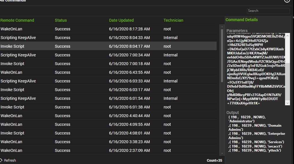

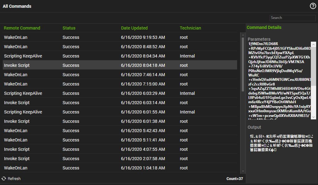

Hi Cubert,
Sorry for the delay, i got caught on something else. When checking the command page, i dont see the Execute Command entry for AdMon.
On the working machine i see an Invoke Script entry, and the results returned, teh failed machine is returning in a different language

Re: ADMon not detecting all machines at a site
Hi Cubert,
I am having the same issue as yardstick, however on the failed device it displays in English.
- Failed to create temporary file. Username: domain\username. Profile. folder not found. Validate user has previously logged into the system.
See screenshot:
I did some more investigations and this is down to the client location 'Deployments and Defaults' password in automate being a domain account. Plugin worked previously using. domain admin\user account.
See screenshot:

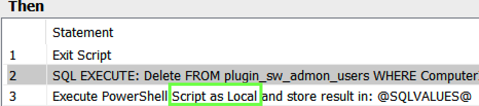

Hi All,
If your having this issue please change the script - Admon Maintenance Service
Line3 to run as local system from 'Run as Admin'
Thanks All
Thanks All
