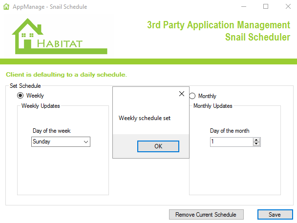

When you have time, can you take a look at the Snail Scheduler? In your screenshot, when you saved the set schedule, the green text reflected what you set. When I tried that, the green text did not change, and it still says "Client is defaulting to a daily schedule." The "Remove Current Schedule", doesn't seem to have an effect because I don't think the schedule is getting set. Do you need a snail button on the App manager main console in addition to the turtle and rabbit button to activate the snail schedule? I'm going to reboot our LT server in case the update didn't load properly, but I wanted to pass that observation along. Please see attached.
Ok this may sound like a stupid question but once you clicked "OK" did the green text not change afterwards? If you close and reopen the Snail scheduler does it still say Defaulting to daily after change?

To confirm, clicking ok and save and then reopening has no effect and it does not change the green text.

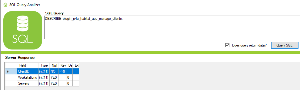

I actually saw some of those tools when I initially looked into Habitat and I agree about all these tools having a significant benefit. I thought, cool, the SQL tool will allow us to do things without having to do back-end scripts or having to open up tickets for support to help us.
I somewhat assumed that I needed to do some prerequisites before using the SQL query analyzer and that I had to first target the tables before running any statements.

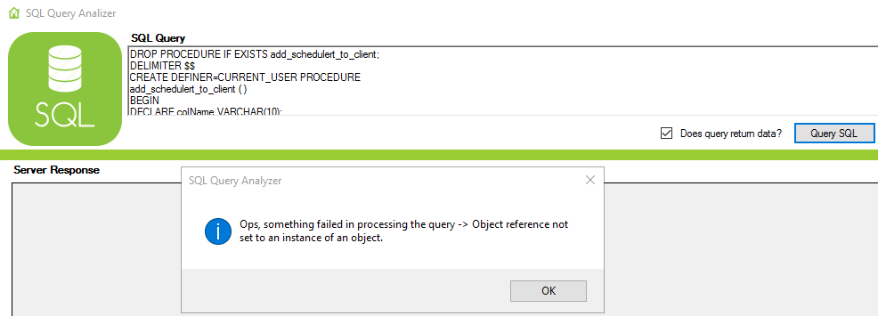

I threw the query/statements in and this is what was returned.
The add column query returns no data so should not be checked.

I also ran the drop query without the box checked and it did not throw any error. However even after restarting the database agent and even disabling and reenabling the Habitat plugin, I still don't see the additional field from the first query that you mentioned. I checked the schedule just in case after everything restarted, and it's still isn't working. Any thoughts?
Yes I should of guessed that would happen..
The query editor is running as the person logged in and you only have permissions to insert, update, delete, and read data at this level. You need to be running as the Automate Host (DBAgent) to alter or change database structure.

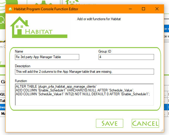

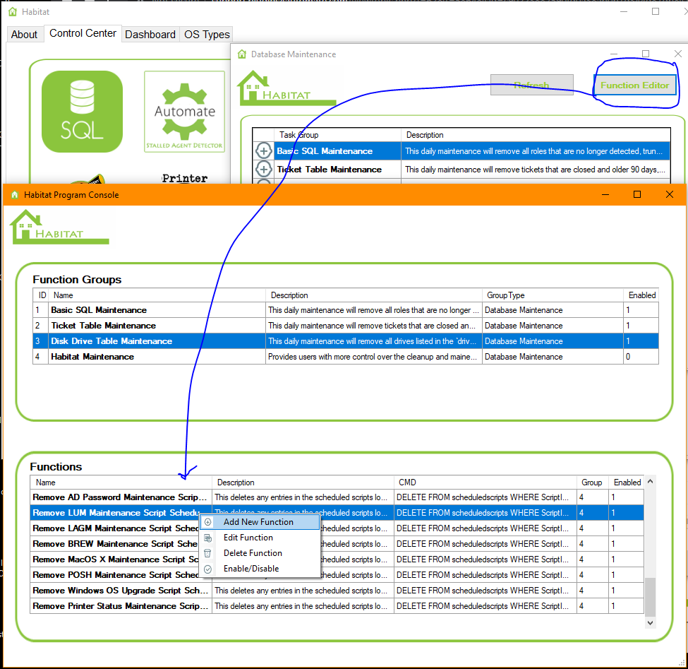

If you launch the database maintenance tool from Habitats main control console it will allow you to create your own database maintenance functions that do run as the Automate host.
All you need to do is create a function then place it inside an enabled group and enable it.
But I would suggest that you create a new group first, then create a function and add that group ID to it.
Right click the groups to create a new group, Right click the functions list to create a new function.
Now give your function a name and description, place in the group ID and paste in to the function area:
ALTER TABLE `plugin_p4a_habitat_app_manage_clients`
ADD COLUMN `Enable_Schedule` VARCHAR(10) NULL AFTER `Servers`,
ADD COLUMN `Schedule_Value` INT(2) NOT NULL DEFAULT 0 AFTER `Enable_Schedule`
Now right click new group and new function and enable them. This will run at 12 midnight and can be disable in the morning after. The function will now run as the Automate Host and should alter table as needed. There no worries if function was allowed to stay enabled past one day, it would just fail as columns now exist so it will not cause a problem if forgot for a few days before disabling. I should extend the function control to allow one time uses and then auto disable it's self. I will look at adding in this feature for future needs.
