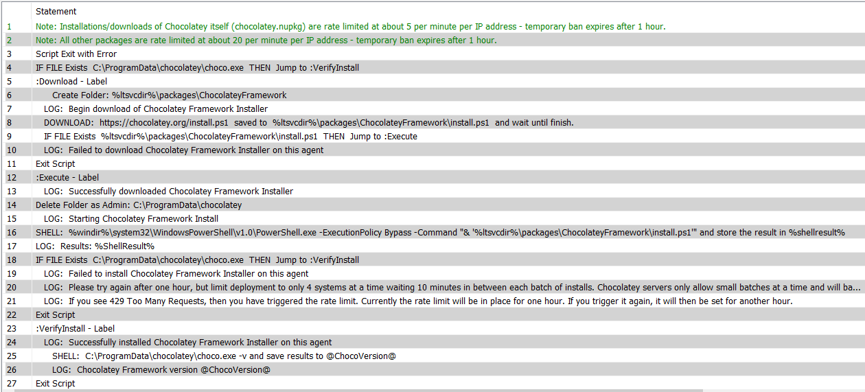

I am writing about the Habitat 1.0.0.73 build, specifically the 3rd party patching component. I think this product is great with some very useful features. However, I have a few questions and observations that affect its ability to be used in a production environment. I realize that this component utilizes the Chocolatey framework, and that may be where some of the limitations reside. I have a couple of suggestions or feature requests to help overcome those issues.
1. Habitat requires that the Chocolatey framework be installed before it can function properly. That's all good, but there are a few limitations and setbacks with that. First, the framework can only be downloaded in very small increments. We have found that if you are running the habitat script or the Chocolatey framework on more than five systems per minute, then you will be locked out from the Chocolatey site. Downloading the script and all components and launching it from your own Labtech server will fix that. Chocolatey does have instructions on how to set up your own server to provide the chocolatey framework installation, but that is a bit of an inconvenience and requires maintaining that PowerShell code and some prerequisites. If there were a way to build in a limiter of 5 per minute into the application, that would resolve that issue without having to jump through these hoops. Secondly, the scripted download of the framework that is built into the Habitat main script only works on certain types of Windows installs or only after security is partially disabled on those systems. It does download on some systems, mainly only on workstations with security lowered, but we have found that the PowerShell download and execution on line 16 of the Habitat App Manage Maintenance Script does not work on over 90% of our systems which are all built with default security left enabled. We have found line 16 does not work on any of our newer servers or virtual desktops. We have corrected that setback by using the following script on systems which is nothing more than downloading first and then launching the PowerShell differently. It's nothing fancy and could use some polishing, but it was a quick down and dirty method for us to move things along before we could even use Habitat. It still must only be deployed to no more than five systems per minute with a 5-minute break in between each, or just only do one system per minute. Also, if you hit the rate limit, the execution would stall, and you would have to use a method to delete the folder and start over, which we dealt with in line 14 below, or you will be stuck in a loop of the framework being partially installed.
Chocolatey Framework.PNG (53.74 KiB) Viewed 61328 times
2. The second setback we noticed is if you're trying to patch more than a half dozen systems with a half dozen apps to be patched, then they will all fail. This process works fine in a small testing environment, but deploying this to a production network results in immediate failure with only the first system working. This is because there is a rate limit of 20 packages that can be checked per network for upgrade per minute, and then you are locked out for an hour or longer depending on how many systems the Habitat script ran on since the lockout keeps getting extended. We like the Habitat product and feel it has tremendous potential, but for production networks, we were hoping that a rate limiter can be put in place to allow the software to work properly. Otherwise, your forced to disable the script and just run it manually on systems at once per minute to allow it to work. This will allow Habitat to abide by the Chocolately rate terms, so no more than 20 packages are ever called within one minute. Something such as only allowing one system to be patched per minute would allow a slow and steady progression of the patches allowing for all systems to be completed without hitting any rate limit by the Chocolatey servers. When doing initial patching with multiple apps, it will only take a few systems to cause a failure in the whole process, and a limiting feature would allow a slow and steady rollout. Is there a possibility for adding a button to the customer location in the 3rd party patching window to limit the habitat script to one system per minute as a rate limiter? Adding a limiting button would allow both the framework and the packages to fully run on any one system but not proceed to the next system until the next minute. This would allow any framework or packages to finish before moving on to the next, permitting a slow and smooth rollout without failure.

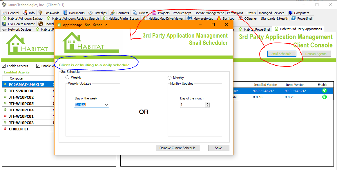

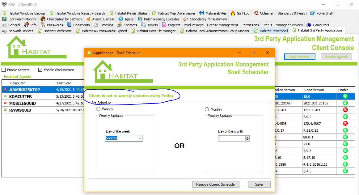

At the Client Level you can configure the Snail, The Snail is a optional setting which will further reduce when the scheduled scripts for updates run. Options are once a week on a given day or once a month on a given day. During that day the system will cycle through all agents under client scheduling installs/updates
Default Rabbit or Turtle configuration
Client with Snail setting configured
Snail works with both Rabbit and Turtle. Rabbit and Turtle controls the number of times per day we test and check and Snail controls what days. So rabbit and Snail, Turtle and Snail or just Rabbit or Turtle. All four configuration types are valid.

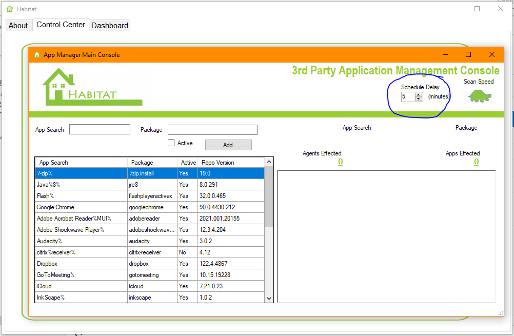

Now for that pesky limiter chocolatey.org controls. We now added a delay in the scheduling of scripts to agents of a client. This control sets the number of minutes apart we will schedule scripts.
I would set this to (1 or 2 ) minutes first before extending delays beyond that. The delay will allow you to set up to 59 minute delays but if you have more than a few agents under any client then setting delay to 59 would only allow 24 agents in a day to execute (per client) . A client with 100 agents set to a 2 minute delay will require a 200 minute window total to schedule all agents within. That's a little over 3 hours of time for all agents to complete the updates.
We have also updated the script to attempt a second install if first fails. It will use the process of downloading the install.ps1 locally then executing using powershell directly.

Thank you for looking into this. Everything you mentioned sounds great. The issue with the choco framework install is that you are calling the execution from the same line that is downloading it. That trips some kind of security issue in server OS's and newer OS's and virtual platforms. If you check out the screenshot in my original post, I included a full working copy of what we use to deploy the framework and it works very well with just some minor logic. The general idea is that if you download it first and then call PowerShell and then point it to the pre-downloaded PS1 from a local location instead of a temporary location, that gets around any Microsoft default security gotchas. I just haven't gotten around to adding any limiting into the script, so we just have to launch it with a scheduler. I'm hoping if you could implement something similar into the master Habitat script then we won't need ours anymore.
Thanks for your time.
Yeap all done,
The script now tries twice to install, first the original way and if it fails then it tries your way before continuing or failing out.
The scheduling has also bee handled. You can now set a delay time in minutes where the script with be scheduled that many minutes apart from the agent scheduled before it (per client). You should now be able to control the flow speed in which agents get their updates and installs. Do not need to add anything into script to limit speed yet. We will look at that after we see how the schedule delay works. We might need to add a sleep function to script during updates if loop goes over 20 so that it doesn't cause 1 agent to lock updates out for next agent coming to do updates.
