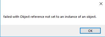

Hi
I receive the following error when I open Chocolatey for Automate:
Anybody seen this before?
The plugin does open, but any actions I do within the plugin, result in the same error message popping up

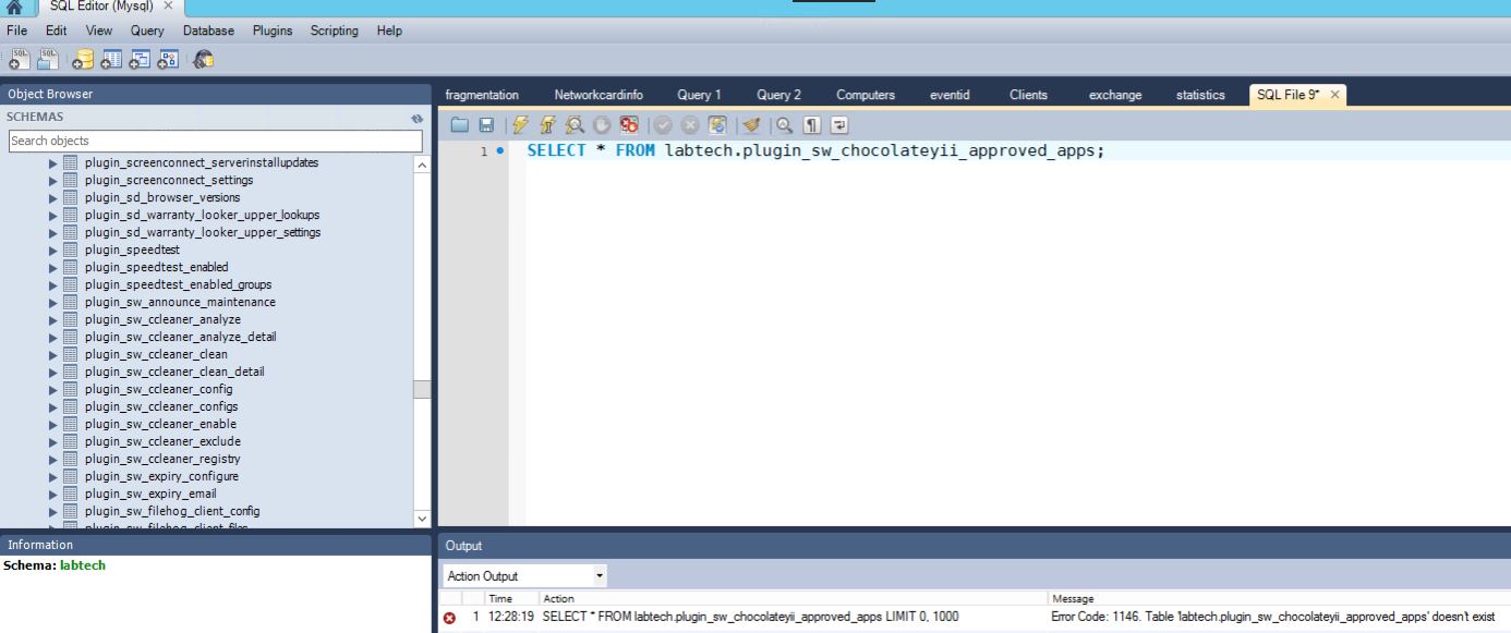

Re: Error When Opening Chocolatey
If you have no SQL tables, then that's the issue for the error.
So first reconfirm missing tables by running the following
SELECT * FROM labtech.plugin_sw_chocolateyii_approved_apps;
Should return the following, (Your list of approved apps, if any)
Do you get this? If not restart the LThosts DB agent and wait 3 minutes and recheck.

Thanks again for the info, but still no joy. I have even rebooted the server and I still get the following:

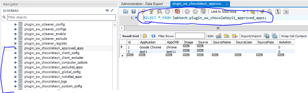

Is this Chocolatey for labtech or the newer chocolatey for Automate?
If Automate then this is the table names, do you have these?

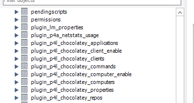

This
Or
That
