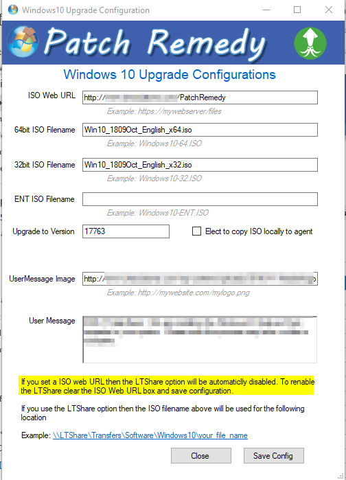

We have the ISO hosted in our webspace and the configuration for PR set to pull the ISO from there.

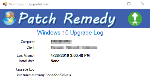

I then moved my computer into a location with no Drive variable. Did the update config, verified in the Effective policy that nothing was set for the network share. I triggered the update again and this time it gave me an error I believe saying the location didn't have a LTShare set, but I am trying to recreate to verify.

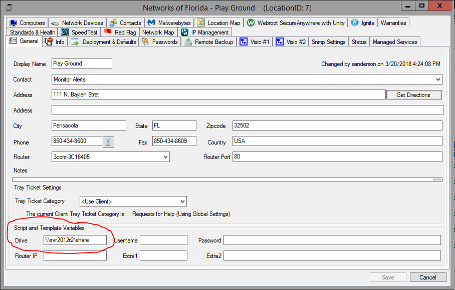

To actually get it to install, I had to set the Drive variable to \\127.0.0.1\LTShare, create that folder on my desktop, share and share it. Then it finally let me do the upgrade.
Based on the documentation I have read, the webspace option disabled teh LTCache option and is supposed to be for if machines are unable to reach the ltcache, so I am a little perplexed if why it is needing an LT cache to download and install from the webspace..

I had someone review the script code and even it looks to be requiring a drivelocation no matter what even though that is not what the setting page nor the documentation say when using the web URL
Even with this set like this, I get this error when trying to update a machine in a location with no drivelocation set.

PR uses the WEB URL to find and download what is typically 4G+ of ISO file for either 32 or 64 bit OS, the potential download could be over 8GBs to cover both platforms. If we were to do this for every agent the bandwidth required would drowned out a company internet access. So to prevent this PR instructs the first agent that attempts the the upgrade to cache the ISO to a local network share "Location Drive" before attempting upgrades. Every agent then looks to this cache first to see if the ISO they need exists there. If not, the next agent will attempt to do the same caching.
The script looks to see if this location is set in configs for each company's locations.
If this is not set and available then the process will fail.

If you want to bypass the location drive then this is the acceptable work around.
But keep in mind that every agent will cache the file locally and no other agent can access ISO locally. For locations where multiple agents are at same location expect to see bandwidth spikes.
You can also create a location for remote users to be stored and apply those settings to that "remotes" location which one would expect all agents to be on seperate networks.
