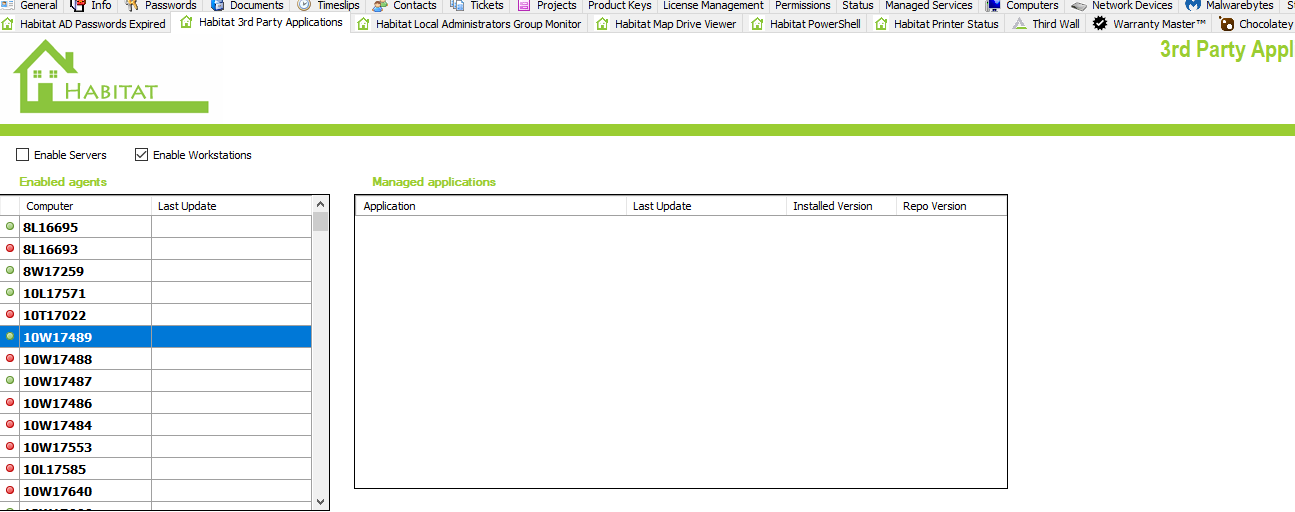

I am sure I'm missing something.
- in the main console I've got all the apps enabled and it shows "affected agents" so I know it's scanning them.
- under a client i have workstations turned on but nothing shows up in the managed apps
- habitat logs look to be scanning at 1 am or whatever time they run normally it appears

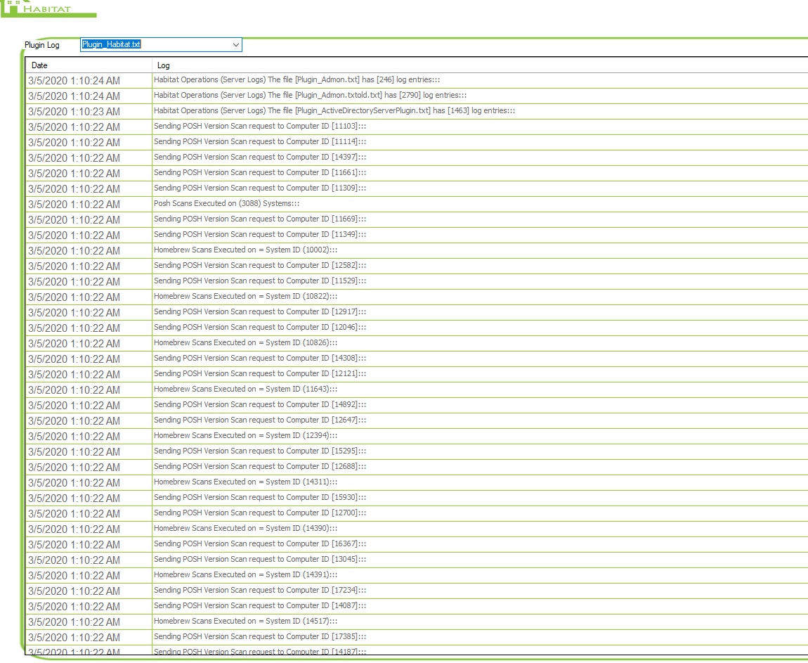

I have had it on rabbit for a few days now.
The only thing I see really in any of the habitat logs is the POSH scans and homebrew. There is nothing about App manage automation, app manage maintenance service, agent update checks or associated app on agent ID.
When I look through all the scripts I don't see anything in here for app manage. I wonder if the install didn't take properly?

I think I have similar problems, although not all agents are empty, however in mine I noticed that the app_genie plugin log file showed some earlier events saying the license had expired (I used to have app genie trial. I removed both app genie and habitat, then reinstalled habitat, but not sure if that solved the problem with the license).
I still have online machines with no apps and I have it on fast scanning. Could be these machines have zero apps that are in the applications list, but seems fishy...

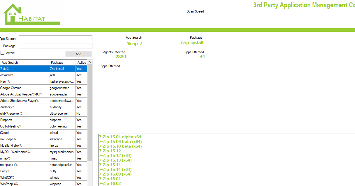

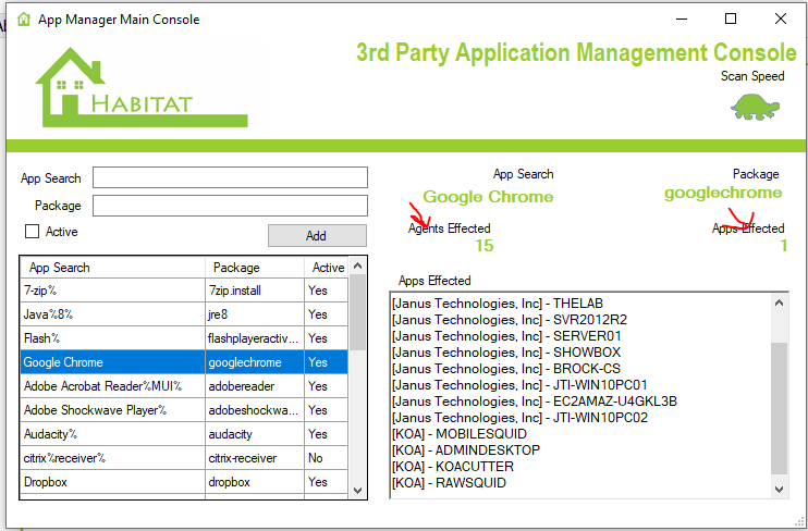

I am adding to the main 3rd Party App Console a new view feature where you are able to select between showing apps effected and agents effected.
Click either Agents or Apps to change the views from the agents effected by search or Apps effected by search.

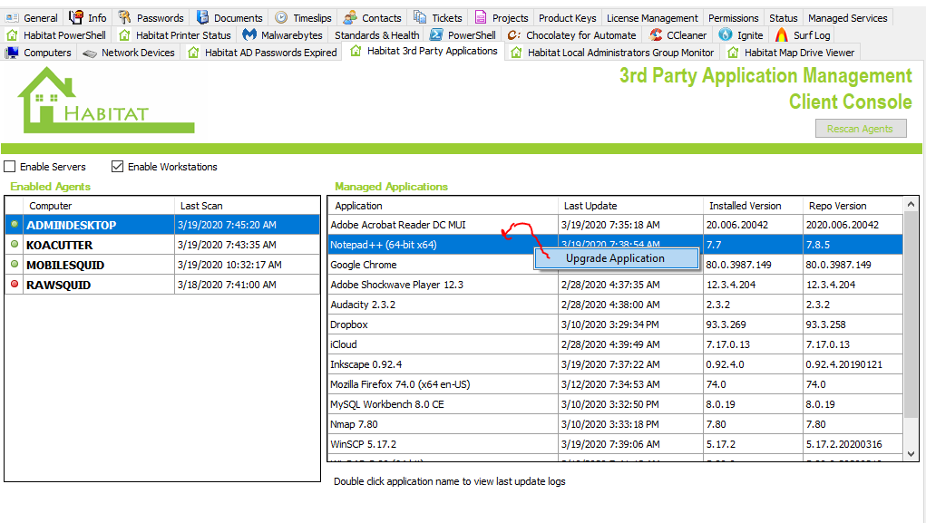

Re: 3rd party app plugin not working
Post by cires316 »
I can see the managed apps now when I click on the computers so I think that part is working.
Is there not a way to selectively update a single app as opposed to updating all of them for an agent?
Not before you asked for it, but with our next release 1.0.0.35 its now in there.
In next build you can select app and right click it to update just that app right now. A terminal will display the progress in the plugin and then the results of the upgrade command. Double click app will bring up the last command log for upgrades if you want to see the last log status of app updates.
