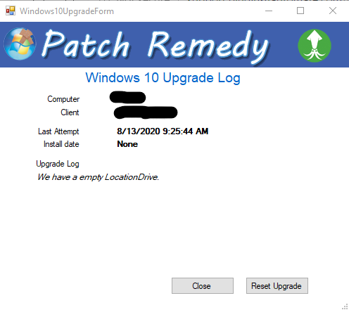

I'm getting the above error when trying to push Windows 10 feature updates to some systems.
Last night, I pushed feature updates to three systems. All three received the .ISO (via web URL, though I have since tried both methods with the same error) and the update started on all three. One of the systems, the one that continues to get the error now, was logged in and the user failed to respond to the prompt and it cancelled. The other two upgraded fine. Ever since the cancelled installation, I've been getting the above error. I've reset the upgrade for this system via Patch Remedy, I've rebooted the impacted system and I've updated the config for that system with no change.
See attached screenshot for the error:
Annotation 2020-08-13 105312.png (37.97 KiB) Viewed 17863 times

Make sure that the "Location" console has a drive location set here. If blank it may fail.
