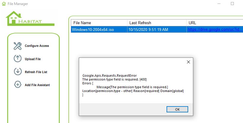

I followed your post to set up the Google Drive integration and it detects my files on Google Drive, but when I click "Add File Assistant", it generates an error, then states that the upload was complete. When I refresh the file list, it appears as an untitled and invalid file. Confirmed it's the same directly on Google Drive.
See attached screen captures. Is there a place I can manually download Habitat-GDLFD.exe from so I can drop it into my Google Drive without using the Add File Assistant button in the plugin?

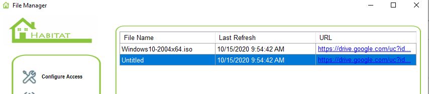

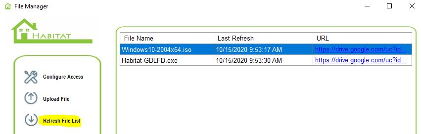

Sorry if I'm not being clear. I already have the ISO on Google drive, it has always been there. The plugin sees the files just fine as I indicated in my original post.

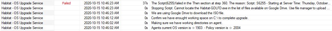

The problem I'm having is with deployment. If I trigger a deployment to a computer, this is what I'm seeing in the script logs:
This is the log for the failed script at the top of that list:
The Script(6255) failed in the Then section at step 360. The reason:
Script:	Maintenance\Habitat - OS Upgrade Service- Starting at Server Time: Thursday, October 15, 2020 10:45:46 AM
IF	Variable CheckValueOne (P1): CMD   Comparer (P2): 2   ValueTwo (P3): INSTALLNOW T: 0.0950131
L1	Script NoteNote (P1): Test for Windows OS on agent T: 0.0950131
L3	Script NoteNote (P1): 'Test for Master Switch to be on, we do not execute if switch is off or setting does not ex...' T: 0.0950131
L4	Variable SetSetType(P1):11   Parameter(P2):'SELECT count(Value) FROM `plug...'   VariableName(P3):MasterSwitch T: 0.0950131
L5	Variable CheckValue (P1): MasterSwitch   Comparer (P2): 2   To (P3): 0   Jump (P4): :MASTERSWITCHISOFF T: 0.0950131
L6	Script NoteNote (P1): See if we have a Policy ID passed to us T: 0.0950131
L7	Variable CheckValue (P1): POLICY   Comparer (P2): 2   To (P3):    Jump (P4): :WINDOWS10POLICYMISSING T: 0.0950131
L8	SQL ExecuteSql (P1): 'UPDATE `plugin_p4a_habitat_windowsupgradepolicies` SET`LastUsed` = NOW() WHERE `ID` = '11'...' T: 0.0950131
L9	Script NoteNote (P1): Get Windows current version on agent T: 0.0950131
L10	Variable SetSetType(P1):0   Parameter(P2):'HKEY_LOCAL_MACHINE\Software\Mi...'   VariableName(P3):Win10Version T: 0.0950131
L11	Variable CheckValue (P1): Win10Version   Comparer (P2): 8   To (P3): -9999   Jump (P4): :MISSINGWIN10VERSION T: 4.1202945
L12	Variable CheckValue (P1): Win10Version   Comparer (P2): 1   To (P3):    Jump (P4): :MISSINGWIN10VERSION T: 4.1202945
L13	Variable CheckValue (P1): Win10Version   Comparer (P2): 2   To (P3):    Jump (P4): :MISSINGWIN10VERSION T: 4.1202945
L14	Script NoteNote (P1): Load Upgrade Policy from SQL T: 4.1202945
L15	SQL Get DataSetSQL (P1): SELECT * FROM plugin_p4a_habitat_windowsupgradepolicies WHERE ID = '11' T: 4.1202945
L16	SQL Fetch DataSet RowVariable (P1): sqldataset   RowIndex (P2): 1 T: 4.1202945
L17	Variable SetSetType(P1):1   Parameter(P2):MaxSold   VariableName(P3):PolicyName T: 4.1202945
L18	Variable SetSetType(P1):1   Parameter(P2):   VariableName(P3):ISOWEBURL T: 4.1202945
L19	Variable SetSetType(P1):1   Parameter(P2):   VariableName(P3):ISO64BitFile T: 4.1202945
L20	Variable SetSetType(P1):1   Parameter(P2):   VariableName(P3):ISO32BitFile T: 4.1202945
L21	Variable SetSetType(P1):1   Parameter(P2):   VariableName(P3):ISOENTFile T: 4.1202945
L22	Variable SetSetType(P1):1   Parameter(P2):2004   VariableName(P3):ISOVersion T: 4.1202945
L23	Variable SetSetType(P1):1   Parameter(P2):@sqlCopyFileLocally@   VariableName(P3):CopyFileLocally T: 4.1202945
L24	Variable SetSetType(P1):1   Parameter(P2):0   VariableName(P3):UseGoogleAPIKey T: 4.1202945
L25	Variable SetSetType(P1):1   Parameter(P2):0   VariableName(P3):UseNetworkCache T: 4.1202945
L26	Variable SetSetType(P1):1   Parameter(P2):   VariableName(P3):NetworkCacheLocation T: 4.1202945
L27	Variable SetSetType(P1):1   Parameter(P2):   VariableName(P3):NetworkUser T: 4.1202945
L28	Variable SetSetType(P1):1   Parameter(P2):   VariableName(P3):NetworkPwd T: 4.1202945
L29	Variable SetSetType(P1):1   Parameter(P2):   VariableName(P3):UserImageURL T: 4.1202945
L30	Variable SetSetType(P1):1   Parameter(P2):Windows 10 Update Beginning   VariableName(P3):UserMessage T: 4.1202945
L31	Variable SetSetType(P1):1   Parameter(P2):0   VariableName(P3):OverRideUserStopAction T: 4.1202945
L32	Variable SetSetType(P1):1   Parameter(P2):1   VariableName(P3):UseGoogleDrive T: 4.1202945
L33	Variable SetSetType(P1):1   Parameter(P2):'13mGOZ99Hlqfay98Cz0yd4EE41MIaT...'   VariableName(P3):GoogleDrive32BitFileID T: 4.1202945
L34	Variable SetSetType(P1):1   Parameter(P2):'13mGOZ99Hlqfay98Cz0yd4EE41MIaT...'   VariableName(P3):GoogleDrive64BitFileID T: 4.1202945
L35	Variable SetSetType(P1):1   Parameter(P2):'13mGOZ99Hlqfay98Cz0yd4EE41MIaT...'   VariableName(P3):GoogleDriveENTFileID T: 4.1202945
L36	Variable SetSetType(P1):1   Parameter(P2):0   VariableName(P3):MasterCacheAgent T: 4.1202945
L37	Variable SetSetType(P1):0   Parameter(P2):'HKEY_LOCAL_MACHINE\SOFTWARE\Mi...'   VariableName(P3):WINEdition T: 4.1202945
L38	Script NoteNote (P1): Test Policy ISO Version against Agent version T: 16.205293
L39	Variable CheckValue (P1): Win10Version   Comparer (P2): 8   To (P3): Value not found   Jump (P4): :PREPAIRFORISODOWNLOAD T: 16.205293
L40	Script Log MessageMessage (P1): Agents current OS version is -> 1903  - Policy version is ->  2004 T: 16.205293
L41	Variable CheckValue (P1): Win10Version   Comparer (P2): 7   To (P3): 2004   Jump (P4): :WINDOWSUPTOVERSION T: 16.205293
L42	Variable CheckValue (P1): OverRideUserStopAction   Comparer (P2): 2   To (P3): 1   Jump (P4): :GETUSERINPUT T: 16.205293
L43	Script NoteNote (P1): Prepair for ISO file download T: 16.205293
L44	Script NoteNote (P1): :PREPAIRFORISODOWNLOAD T: 16.205293
L45	Script Log MessageMessage (P1): Making sure we have working directories on agent. T: 16.205293
L46	Folder DeletePath (P1): %ltsvcdir%\Habitat\windows10UG\ T: 16.205293
L47	Folder CreateFolder (P1): %ltsvcdir%\Habitat\windows10UG\ T: 20.2302958
L48	Script Log MessageMessage (P1): Confirm we have enought working space on C:\ to complete upgrade. T: 26.283022
L49	Execute Script T: 26.283022
L50	Variable CheckValue (P1): CDRIVESIZE   Comparer (P2): 4   To (P3): 15   Jump (P4): :NOTENOUGHTDRIVESPACE T: 36.8478039
L51	Variable CheckValue (P1): UseGoogleDrive   Comparer (P2): 2   To (P3): 1   Jump (P4): :GOOGLEDRIVE T: 36.8478039
L61	Script NoteNote (P1): :GOOGLEDRIVE T: 36.8478039
L62	Variable CheckValue (P1): UseGoogleAPIKey   Comparer (P2): 2   To (P3): 0   Jump (P4): :GOOGLENOAPIKEY T: 36.8478039
L74	Script NoteNote (P1): :GOOGLENOAPIKEY T: 36.8478039
L75	Script Log MessageMessage (P1): We are using Google Drive to download the ISO file. T: 36.8478039
L76	Variable SetSetType(P1):11   Parameter(P2):'SELECT ID FROM plugin_p4a_habi...'   VariableName(P3):Habitat-GDLFD T: 36.8478039
L77	Variable CheckValue (P1): Habitat-GDLFD   Comparer (P2): 2   To (P3): -9999   Jump (P4): :NOHABITATGDLFD T: 36.8478039
L357	Script NoteNote (P1): :NOHABITATGDLFD T: 36.8478039
L358	SQL ExecuteSql (P1): 'INSERT IGNORE INTO plugin_p4a_habitat_win10upgrades_agents (`ComputerID`,`AttemptLog`) Val...' T: 36.8478039
L359	Script Log MessageMessage (P1): 'Stopping Script. Cannot locate the Habitat-GDLFD.exe in the list of files available on Goo...' T: 36.8478039
L360	Script Exit with Error T: 36.8478039

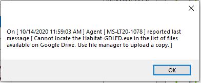

The reason I thought I needed Habitat-GDLFD.exe is because the script failed with the error that it could not detect that file:
If that's not the problem, can you provide any information as to how I can get this working?
