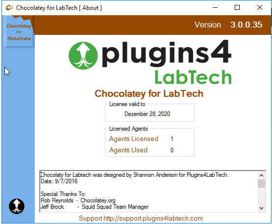

we installed the 3.0.0.36 .dll, but in the tools windows it shows 3.0.0.35.
How can we fix this?

I tried that and the console really did an update.
But the chocolatey plugin still shows 3.0.0.35
And if I look inte the plugin on our client, it also says 3.0.0.35 and more than 70 pending commands.

In the plugin manager it shows 3.0.0.36
2020-12-06 23_48_56-Plugin Manager - __Remote.png (3.19 KiB) Viewed 6317 times
Re: wrong version installed
This looks to be a internal version number mismatch. Once we get some of the logs back from the people reporting pending process so we know if a change is needed in the processor we will get out an updated (fixed) version.
Shouldn't be but a couple of days.
