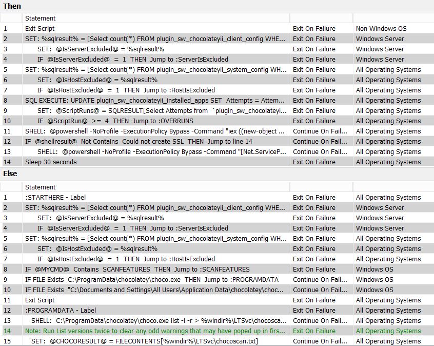

This started happening recently. I have new PCs I'm setting up and the plugin is no longer pushing the Choco framework to them. The scripts show the Maintenance Service is Queued for them but they've been sitting like that for hours. I checked the script itself but nothing appears to have changed in it.
- Capture.JPG (191.42 KiB) Viewed 17582 times

What is queued?
Can you screenshot this queued view?
If its not running just sits there "Queuing" it the scripts log then this is not a "script" issue but something with Automate and the agent not running through the script commands. Could be a one time flub or a symptom of another issue.
Post what you can here so we can see what is going on. Also the ChocolateyForlabtech logs on the automate host will let us know if it is having issues.

It eventually pushed the framework. You were right, it was Automate "hanging" on itself.
