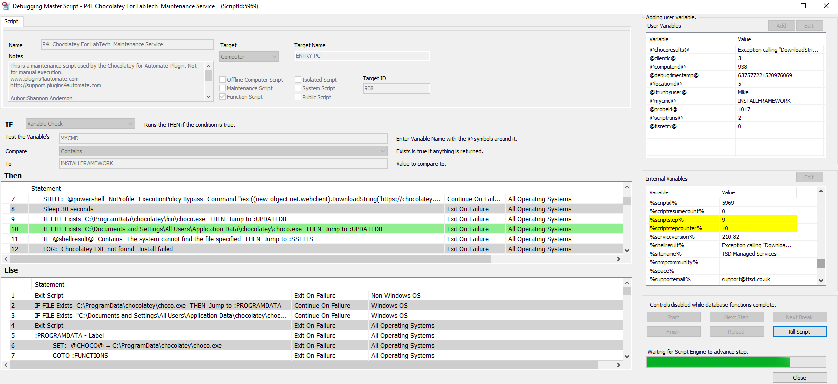

OK, the Framework isn't installing I think because of the TLS issue but I have the magic box ticked. It looks like the @shellresult@ doesn't contain the expected string but instead the output of the Powershell script that is a result of the TLS issue:-(
It never applies the fix so never installs the framework...

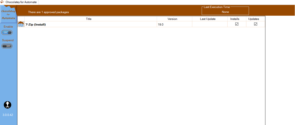

One of our machines, no framework, no attempts, no last execution time - all since the day I installed it :-(
Screenshot 2021-05-27 162810.png (25.33 KiB) Viewed 23622 times
Re: choco.exe missing
I believe this maybe due to limit issues we been seeing lately. We are testing several new updates now to see if we are able mitigate some of these issue.
Please stand by..

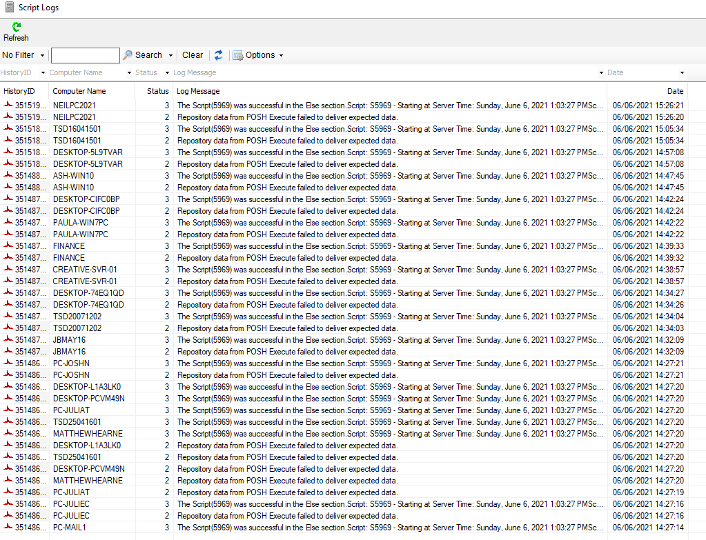

The script seems to bomb out a lot with "Repository data from POSH Execute failed to deliver expected data."
Screenshot 2021-06-06 164041.png (154.33 KiB) Viewed 23466 times
All the log you are showing me here are "Else" logs. This means that these are attempts to install or update applications or updating repo. not install framework. If agents are getting these commands then Chocolatey framework was successfully installed and now the plugin is working on installing and updating applications or other functions.
My concern is that from the log error you show, you are requesting a repo app version update to repopulate the current versions on the public repo. This is all and good but it should only be happening to a single agent and not a list of them.
There should only ever be 1 agent ID that gets this request. The automation inquires as to whom has this task with the following query. if value > 0 then we have a agent to schedule the repo updates against.
SELECT `Value` FROM plugin_p4l_chocolatey_properties WHERE `Name` = 'REPOSCANNERID'
From what I am seeing here it looks like you have many agents trying the same function. Can you run SQL query and confirm to whom the task is presently assigned? If you can answer if that agent is in the list of logs? and then send us the server plugin logs for Chocolatey for Automate?
I have reviewed our functions and do not see how more than 1 agent could be assigned this task. There is no loop to assign multiple scheduled scripts to agents for this function. I have also reviewed the functions that do loop through multiple agents and non assign the repo update task. I also confirmed that script functions all have terminators at the end so you can not cross over functions inside script.
Look forward to seeing the data you can provide.
