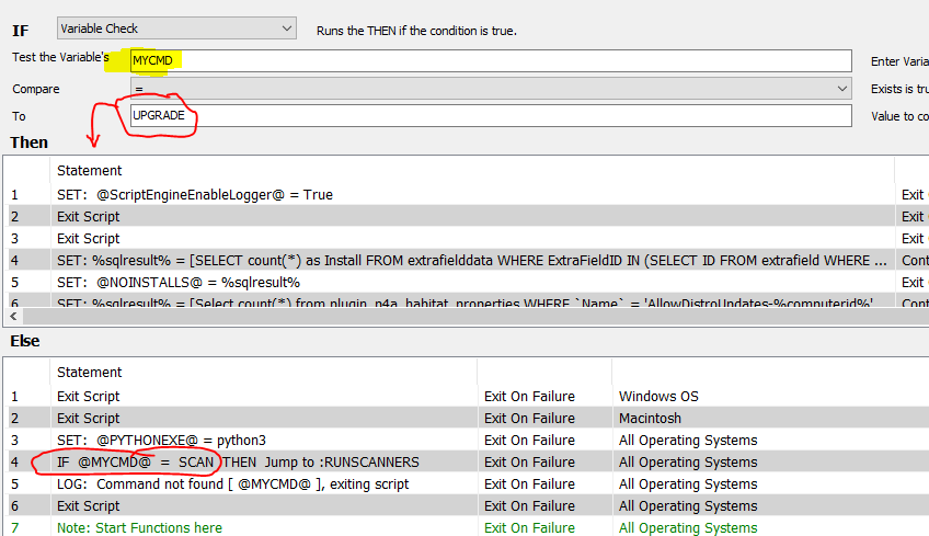

Can i start the script with debug ? What is the first variable mycmd ?

the MYCMD variable is used by Habitat to control what parts of the script get run. Its a means to select functions out of the script instead of running each and every line.
So if MYCMD = UPGRADE then it run the entire Then statement section. If MYCMD = anything else it goes to the else section where we test it further to see if it equals a given command value. In this case we are looking for SCAN, if it is set as MYCMD then we will seek out the scan function in the else statement and execute till the next exit script function.
This allows us to have 1 script but many functions we can call.
You do not need debug, what you need is to view the script and command output logs in the agent console for the time stamps that the script is running. The script should log some data and the executing commands on agent will log the commands return so you can see the raw output from any command execution.

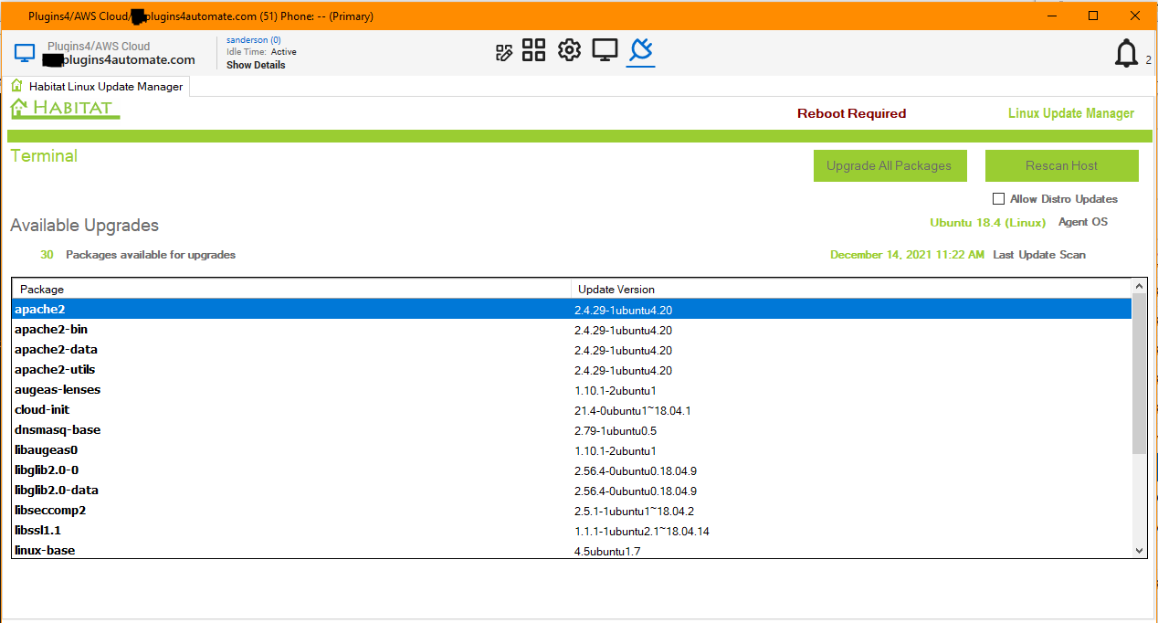

I have corrected this in the next build due out ASAP (next 24 to 48hr.) Should be Habitat build 1.0.1.14. We also tweaked the UI a little bit to make it a bit nicer. Here is a sample of the new layout and working collections.

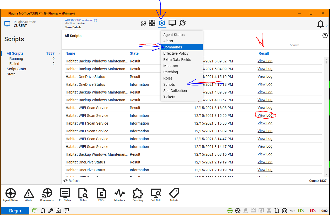

But Can you explain where to look at agent console ? It might be useful for other problems .
Re: Habitat Linux Update Manager shows no Updates
This is the agent console and you should select the gear and then select either commands or scripts to see the logs for either. This is the heart of how to see and troubleshoot automation tasks.

ok, thank you - i know this place but log is only
No results were returned, exiting script-> [OK]
I thought there's a more detailed log
Sometime silence speaks volumes!
The fact you received an "OK" actually tells us that the command returned NULL. A NULL value from a command cause Automate to display "OK". If the value was just blank it would be a blank return or if any data or errors exist it should be that.
OK tells us that most likely the command failed to execute at all which is what we started seeing here. The script function called was read file from agent. This should of returned either file not found or file contents but it returned OK instead. So it saw the file but failed to read it. That's an Automate issue and not the plugin. We had to rewrite the script to call different commands before we were able to start retrieving the files again.
