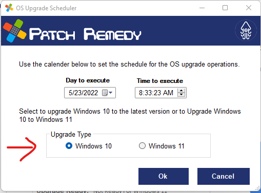

#2 Schedule Upgrade Option - (Schedule OS Upgrade) This will produce the same result as the manual option but allow you to automate the schedule to any time and date you like.

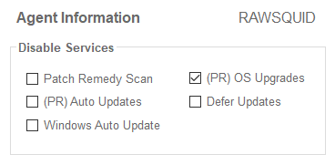

When scheduling agents for upgrades, if the (PR) OS Upgrades is checked the Upgrades are disabled on that agent and no upgrade will be scheduled. The scheduled date will remain set but the feature is disabled so automated upgrade is disabled. This will need to be unchecked for the automated services to schedule the upgrade.

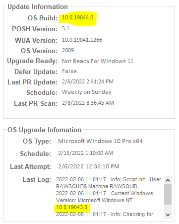

Once the upgrade has been scheduled and the process has been started , you can see the status of the upgrade in the agent view. The Last Attempt is the date it started executing and the Last Log is the results of the execution of the upgrade. You can see from last log that we started with a OS build of 10.0.19043.0 and now are on 10.0.19044.0. Obviously it was successful in the upgrade.

You are getting the “OS Upgrades are currently set to be excluded” pop up when scheduling an OS upgrade.
This can be avoided by first at the client level unchecking the (PR) OS Upgrade box. This will then set all agents under client the ability to auto upgrade if set to do so with a schedule. If you do not schedule a upgrade it will not try to upgrade even with check box off. If check box is on at the time of scheduling that agent will also be skipped even though it has a scheduled date.
The only time scheduling OS upgrades does not test for this check box is if you are scheduling same day updates.
Scenarios
  • #1 Set schedule today for next week upgrade
    (PR) OS Upgrade is checked and you “OK” the pop up message,
    If (PR) OS Upgrade checkbox is checked on the day that the schedule is to run the agent will not be scheduled.
  • #2 Set Schedule today for upgrade later today
    If (PR) OS Upgrade is checked and you “OK” the pop up message the OS will schedule for the time requested.
You can uncheck the agent, leaving the rest of the agents checked. But the next time you load the plugin and view the client, the box for the client will be unchecked. This is because all agents must be checked for this box to be checked. If one agent is unchecked the the client is not fully checked and thus is unchecked. All agents that were checked will remain checked unless you deactivate the check at the client view.
Example: You have used the client checkbox (checked) for (PR) OS upgrade which has set all agents to disabled. You have unchecked a few single agents so now the client view shows unchecked. You want to reapply the all agents disabled, disabling the once enabled agents. Recheck the client checkbox and all agents will return to disabled.

There will be in next builds of Patch Remedy 5 the Windows 10 to 11 upgrade followed by the Windows 11 OS upgrade options." So if I'm reading that right the plugin is smart enough to only upgrade to latest version of Windows 10 and not go all the way up to 11.
Re: Using OS Upgrades in Patch Remedy 5
Correct,
You can only schedule a Windows 10 to 11 upgrade. The manual and standard schedules only upgrade within the same OS. You would have to tell PR to upgrade to 11
You will need to select agents and then select Windows 11 for Windows 11 upgrades to process.
Also FYI,, some people are reporting that the Accept EULA command line switch is not working as desired on some Windows 11 copies. You may experience limited success with 10 to 11 upgrades depending on factors.
