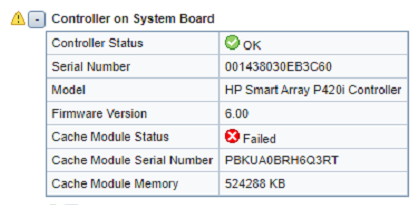

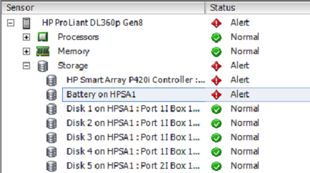

We are experiencing an issue where we have an HP Proliant server running ESXi that reports via iLO/vSphere that there is an issue with the cache module/Battery but the CIM data isn't showing the issue.
Here are some screenshots that show the issue.
Hardware Error Shown in ESXi vSphere Client
vSphere failed ctlr.png (68.79 KiB) Viewed 14408 times
HP iLO showing failed component
iLO failed msg.png (201.14 KiB) Viewed 14408 times

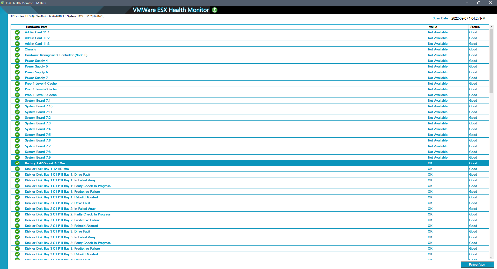

CIM data showing all is okay
CIM Data OK.png (202.65 KiB) Viewed 14408 times
Is there a log we can check to see what is being polled and not reporting correctly or what can be done to address this?

Yea,
Have the probe agent run the following at the command line.. Change for your needs.
viewtopic.php?t=5532
This will spit out the raw cim data we get...
Post the cim dump here
